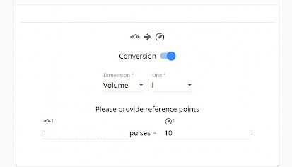

Once the water meter is connected to the Aranet Dry Contact Pulse Counter, correct adjustments for conversion should be made from the Aranet base station web interface.
We should choose the dimension- volume in this case, unit- could pick any of the offered, but in this example will choose liters, and finally corresponding unit count per pulse.&#x20;
<div data-with-frame="true"><img src="https://forum.aranet.com/site/assets/files/4578/screenshot_2023-02-23_100752.413x0-is.jpg" alt="" width="413"></div>

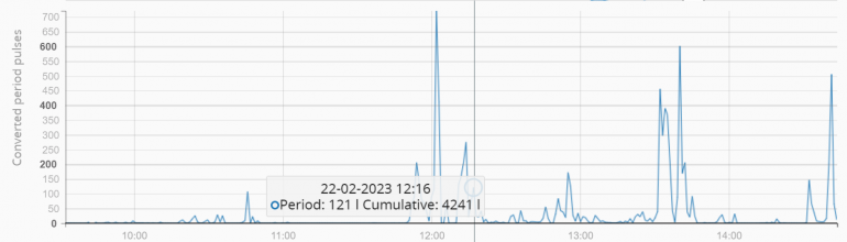

In this example, we can see that one pulse will be counted for every 10 liters that the water meter measures. This can also be displayed in a chart:
<div data-with-frame="true"><img src="https://forum.aranet.com/site/assets/files/4578/screenshot_20230223_104020.770x0-is.png" alt="" width="770"></div>
In this chart we can see already converted pulses to chosen units (liters) per time period. This allows us to get visual interpretation of when water consumption would be bigger in specific time period.
