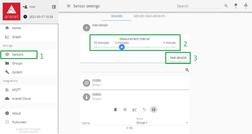

To change the measurement interval for the sensors, you need to re-pair them with the Aranet base station. If you want to preserve measurement readings history, you must not delete the sensor from the Aranet Pro base, but just re-pair. Please keep in mind that pairing should be done in close proximity (< 20 meters) from the Aranet base station.
  1. Log in to the Aranet base station's web interface and navigate to Sensors.
  2. Slide to set the desired measurement interval.
  3. Click Pair sensor and then remove the battery from the sensor and place it back again shortly. When a long flash comes from the LED inside the sensor immediately after the short flash, then pairing is successful. If pairing was unsuccessful, repeat the pairing procedure after 10-15 seconds. In some other cases, you can press the PAIRING button, which is located on the PCB plate of the sensor and is easily reachable, which will trigger the appearance of the sensor, and it will become discoverable. Information about pairing success/failure can also be seen in the Aranet graphical interface.
Now sensor will record new data with the new configured measurement interval in addition to the previously saved historical data.
