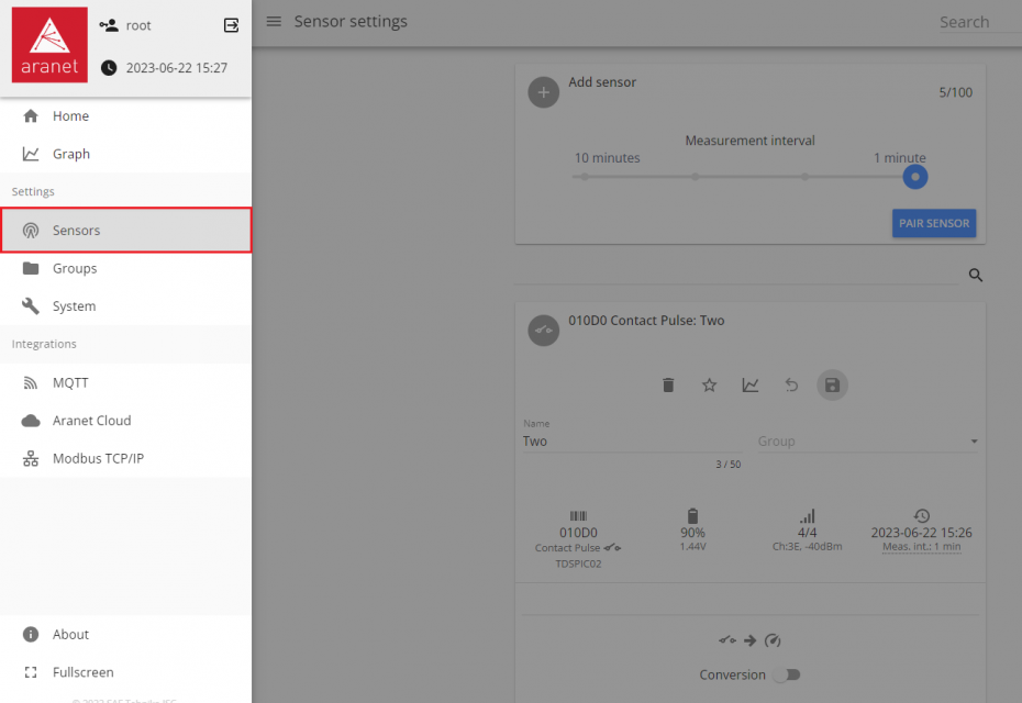

2. In the graphical user interface of the Aranet base station, go to the SENSORS menu:

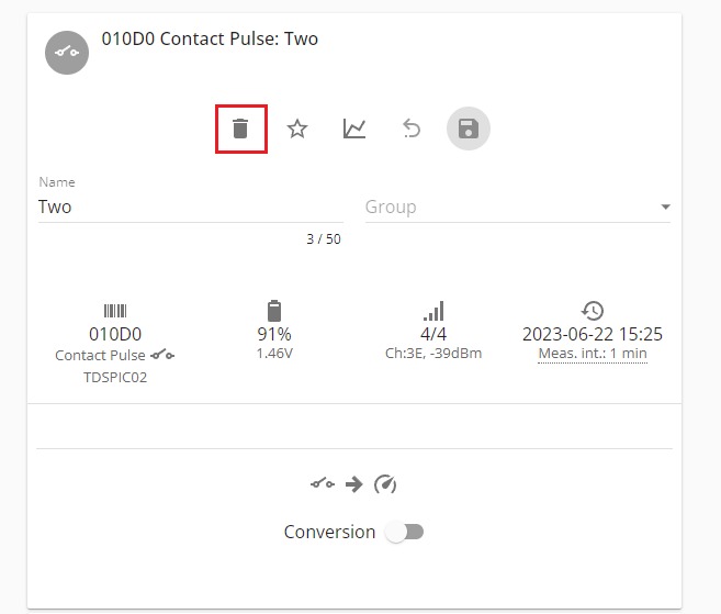

3. Select the sensor you want to delete by clicking on it.
4. Press the delete button.

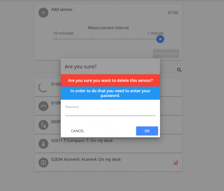

5. Confirm the deletion by typing your password and pressing 'OK'.
