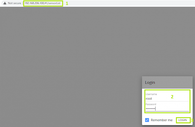

Then log in to the base station WebGUI, using an account with Administrator rights. Explained here: Connecting to Web Interface.

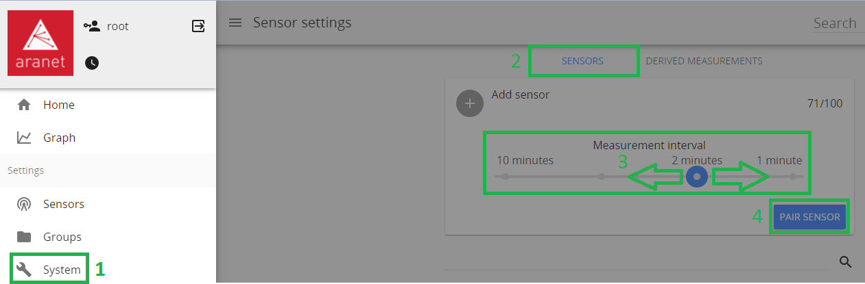

In the graphical user interface of the Aranet base station, go to the SENSORS menu:
Choose the necessary measurement interval (10, 5, 2, or 1 minute) for the sensor. Next to begin pairing procedure click on PAIR SENSOR. 2-minute timer indicated by the closing ring is started:
