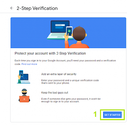

  1. For the Aranet base station to properly authorise to the Gmail server, you have to enable 2-step verification on the necessary account: https://myaccount.google.com/signinoptions/two-step-verification/enroll-welcome
  1. Confirm the operation with your password.

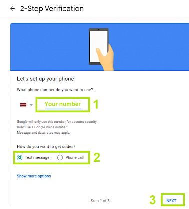

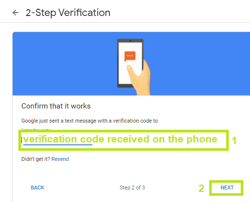

  2. Set up the configuration for the phone that you are using:
  1. Confirm that the connection with the phone is valid:

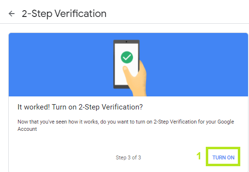

  1. Turn on 2-step verification for your Gmail account:

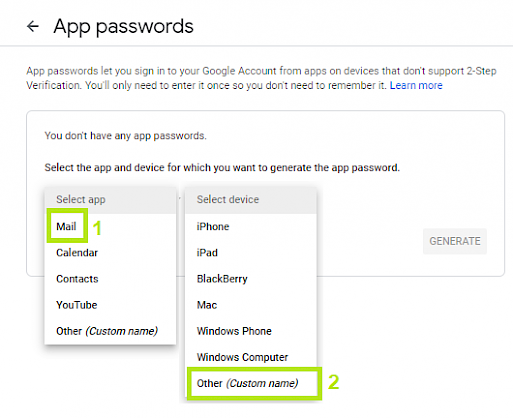

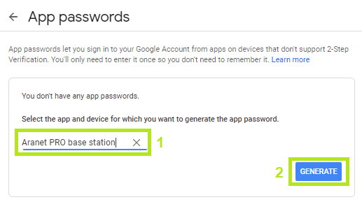

  1. Go to the address: https://myaccount.google.com/apppasswords and create a new password for Aranet base station authorization to the Google Mail server, selecting app = Mail and device = Other (Custom name)
  1. Enter the name for the configuration and press the GENERATE button:

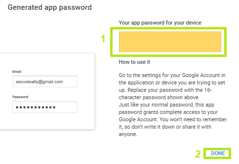

  1. Copy the generated app password from the opened window:

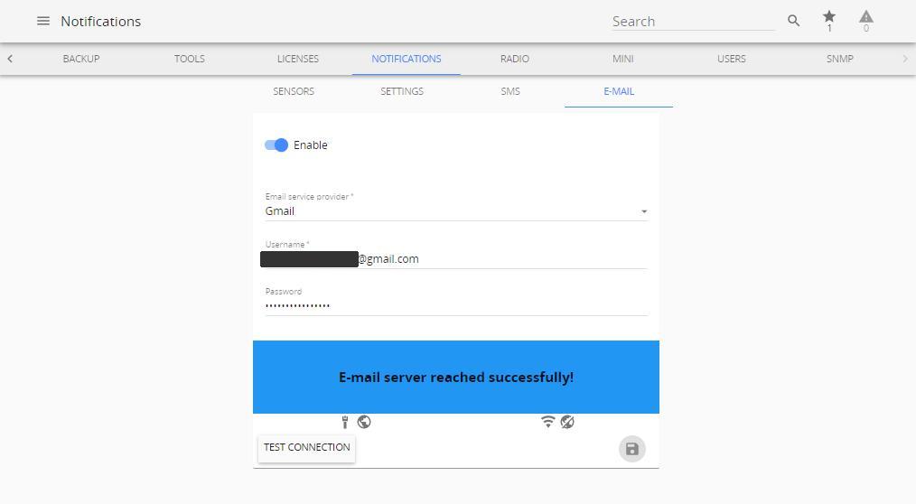

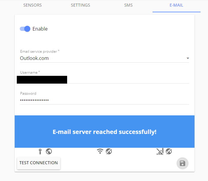

  1. Enter your e-mail and copied password in the section System --> Notifications --> EMAIL in the Aranet base station graphical interface, save the configuration, and test it by pressing the TEST CONNECTION button:

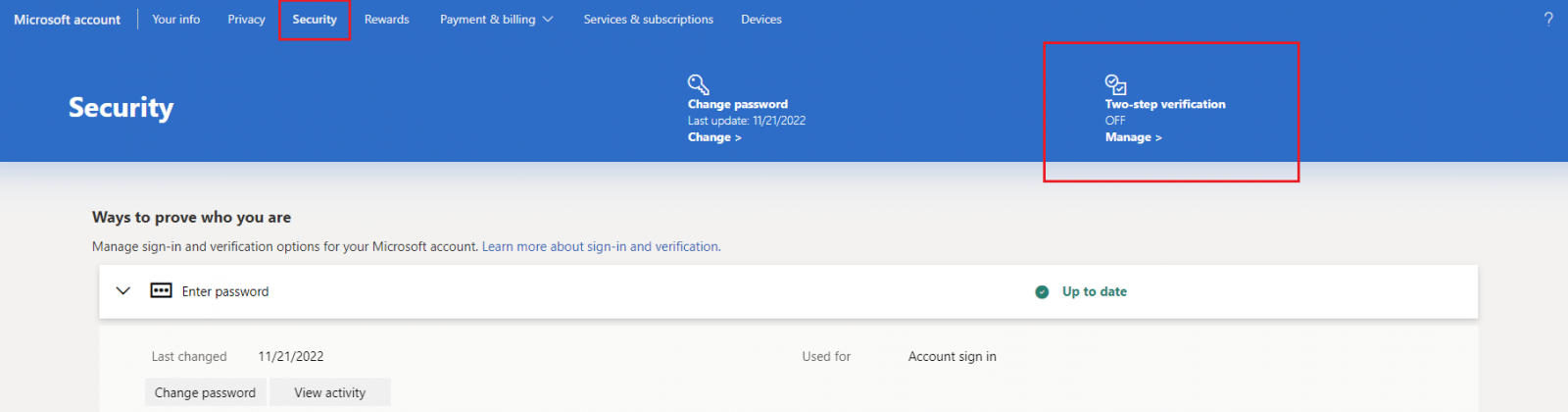

  1. For the Aranet base station to properly authorise to the Microsoft server, you have to enable 2-step verification on the necessary account: https://account.live.com/proofs/EnableTfa
Or by clicking on Security -> Two-step verification

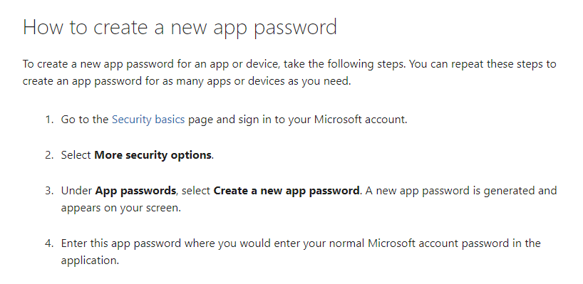

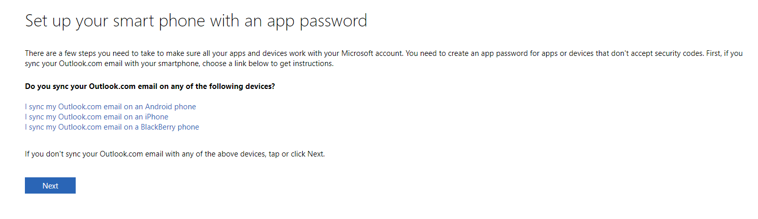

  1. By clicking 'Next', you will be able to see the instructions page with the 'How to create a new app password' part:

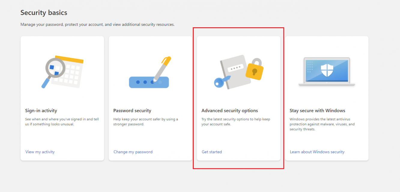

  1. Click on Security basics -> Advanced security options:

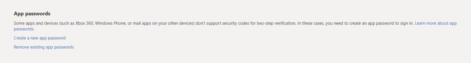

  1. Find the section 'App password' and click on 'Create a new app password':

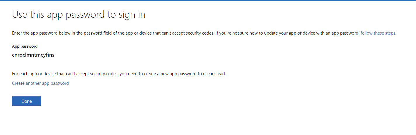

  1. Write down the generated password:

  2. Enter your e-mail and copied password in the section System --> Notifications --> EMAIL in the Aranet base station graphical interface, save the configuration, and test it by pressing the TEST CONNECTION button:

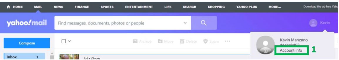

  1. For the Aranet base station to log in with the Yahoo! server, you must enable 2-step verification on the necessary account. For that, log in to your email at https://mail.yahoo.com and click on Account info:

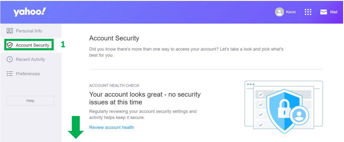

  1. Now click on Account Security and scroll down until you reach ACCOUNT ACCESS:

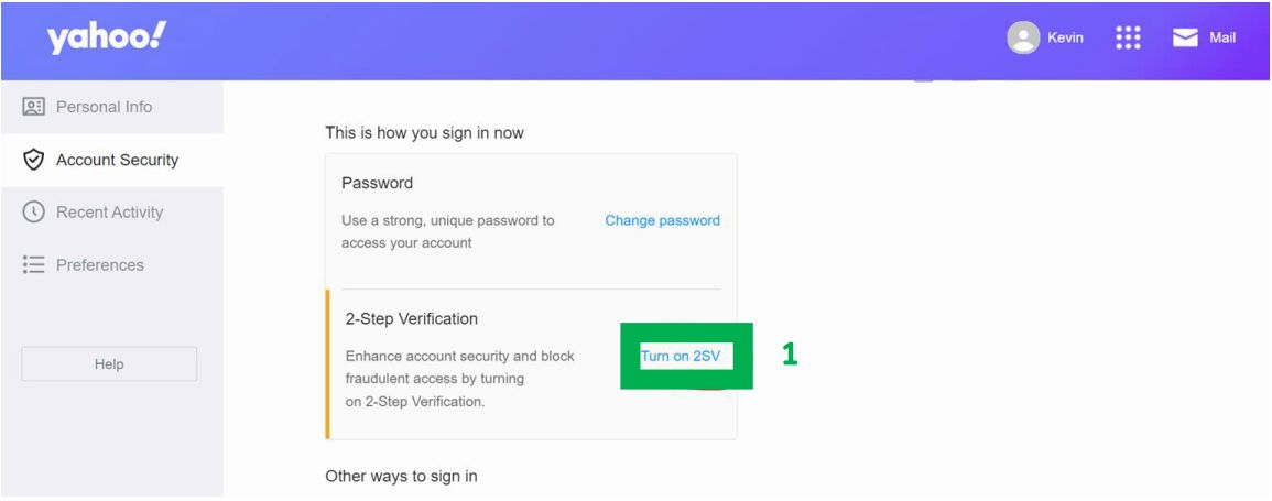

  1. Click on Turn on 2SV to enable the 2-step verification:

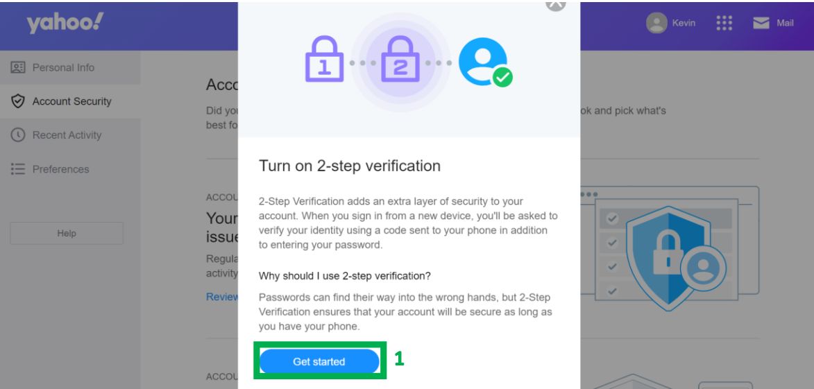

  1. Now click on Get Started and make sure you have your personal phone with you:

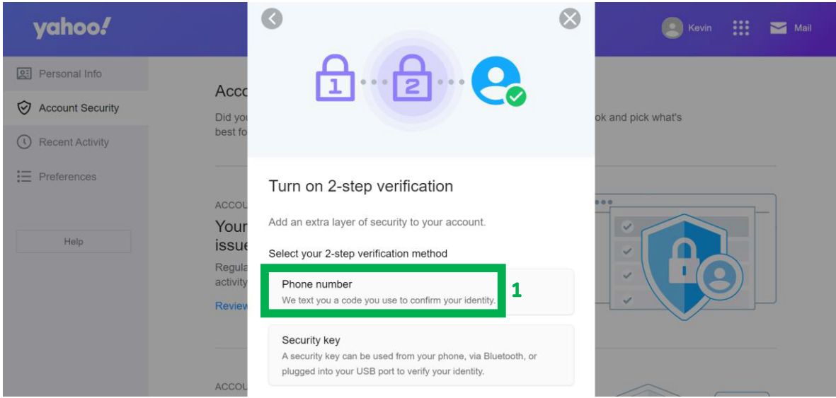

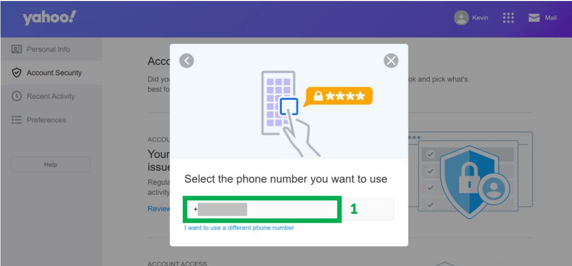

  1. For this example, click on Phone number:
  2. Set up the configuration for the phone that you are using. It will automatically show the number that is linked to the account, confirmed by clicking on it or selecting a different number:

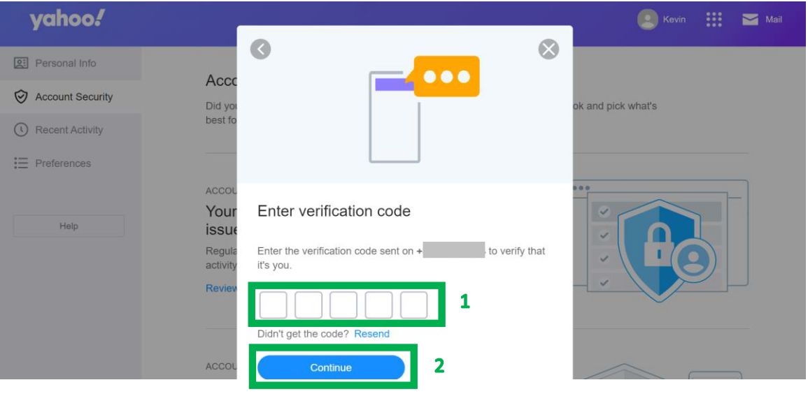

  1. You will receive a code to the phone number provided, enter it in the squares shown, and confirm that the connection with the phone is valid:

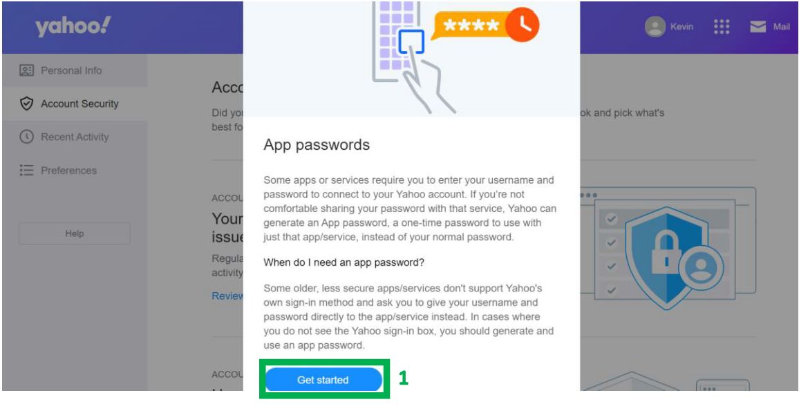

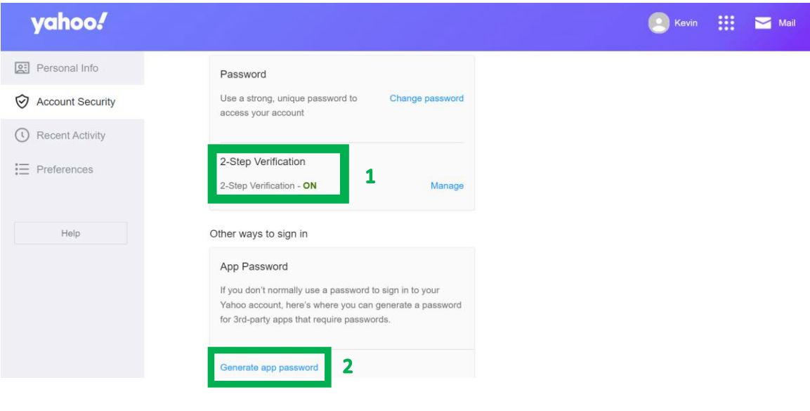

  1. Confirm the process was successful by noticing the 2-Step Verification method is ON. Now generate an App Password for Aranet base station authorization to the Yahoo Mail server:
  1. Click on Get Started:

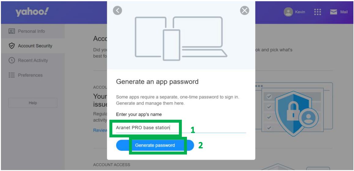

  1. Enter the name for the configuration and press the Generate Password button:

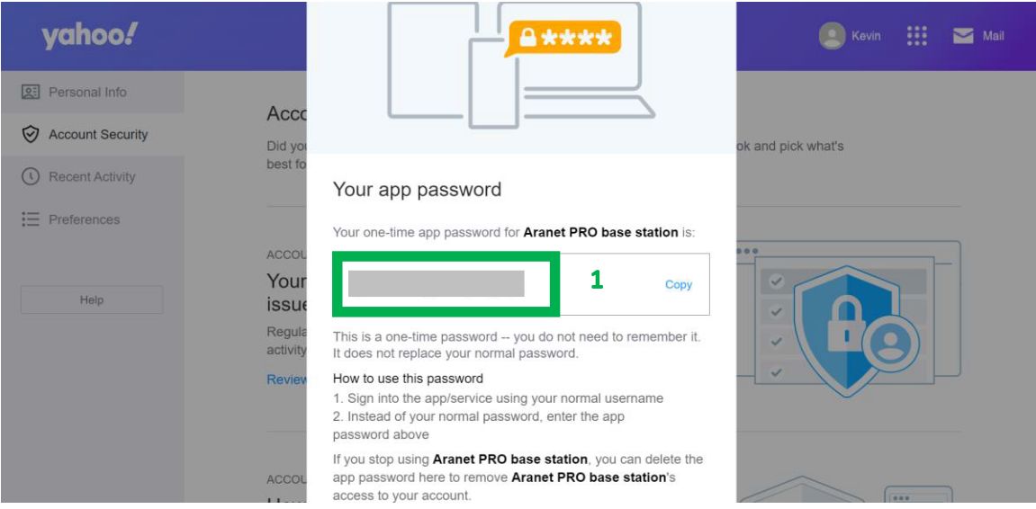

  1. Copy the generated app password from the opened window and use it to log into the app:
