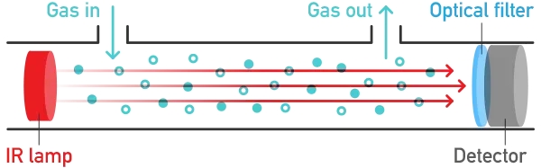

<summary>What is the NDIR sensor and why is it preferred over other types of sensors?</summary>
Aranet4 uses a non-dispersive infrared (NDIR) sensor to measure CO<sub>2</sub> levels. The device features a small gas chamber with an infrared light source, where CO<sub>2</sub> absorbs the light. An optical filter in front of the detector then filters out all light except the wavelength absorbable by CO<sub>2</sub> molecules, enabling a precise CO<sub>2</sub> concentration level measurement. This CO<sub>2</sub> reading method offers higher precision than regular electro-chemical sensors, as it uniquely detects carbon dioxide with no interference from other gases. Furthermore, the NDIR sensor has a much longer lifespan and requires less recalibration than other sensors.
