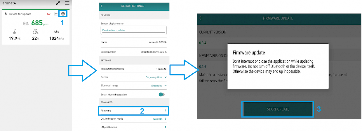

Starting from Aranet Home app version v2.0 firmware update can be done as follows:
1. Click on the settings “wheel” icon in the record of the necessary device;
2. In the newly opened page click on section **Firmware**;
3. Finally click on the button  **START UPDATE**:
<div data-with-frame="true"><img src="https://forum.aranet.com/site/assets/files/1537/firmware_upgradev2.1240x0-is.png" alt=""></div>
**Important!** Sometimes there might be an issue where the sensor is stuck during some operation, for example, a firmware upgrade. In this case, it is advised to open the Aranet4 app and try to add a new sensor. In most cases, this sensor will be discovered, paired back to the app and working again. If the issue still persists, please contact <support@aranet.com>
