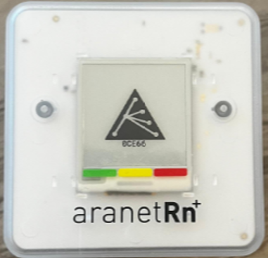

* The screen will not show measurement data and will display the **Aranet logo** instead (similar to the screen disable feature on Aranet4 Pro).

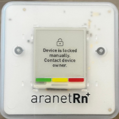

* If the sensor button is pressed, a message will appear indicating that the device is locked and cannot be used.

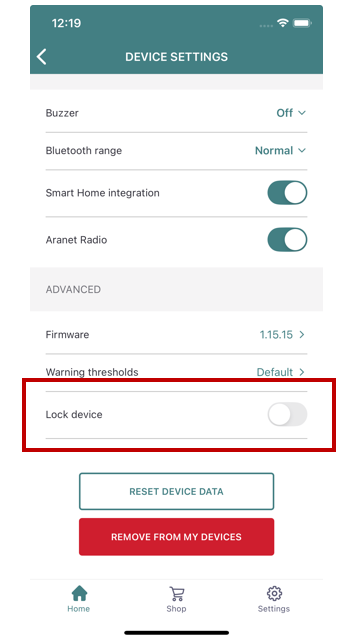

Open the Aranet Home app and go to the device settings. Check if the latest firmware version is installed. If not, update it.
After updating, the Lock device option will become available. Press **Lock device** to activate the feature.

To unlock the sensor, use the Aranet Home app. Open the app and go to the device settings.
Find the Lock device option and press on it. As soon as the switch is in light grey, the device is unlocked.
After unlocking, the sensor will return to normal operation, and measurements will be visible again.
