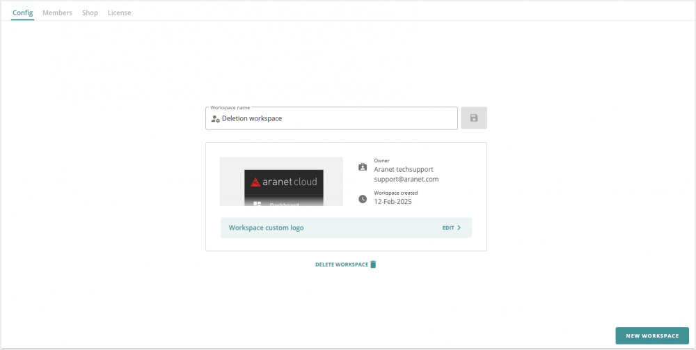

Navigate to **WORSKSPACE** menu **CONFIG** tab, here you can change your workspace name at any time:
<div data-with-frame="true"><figure><img src="https://forum.aranet.com/site/assets/files/4289/image.1000x0-is.png" alt=""><figcaption></figcaption></figure></div>
Locate **DELETE WORKSPACE** button at the bottom of the window and click on it:
