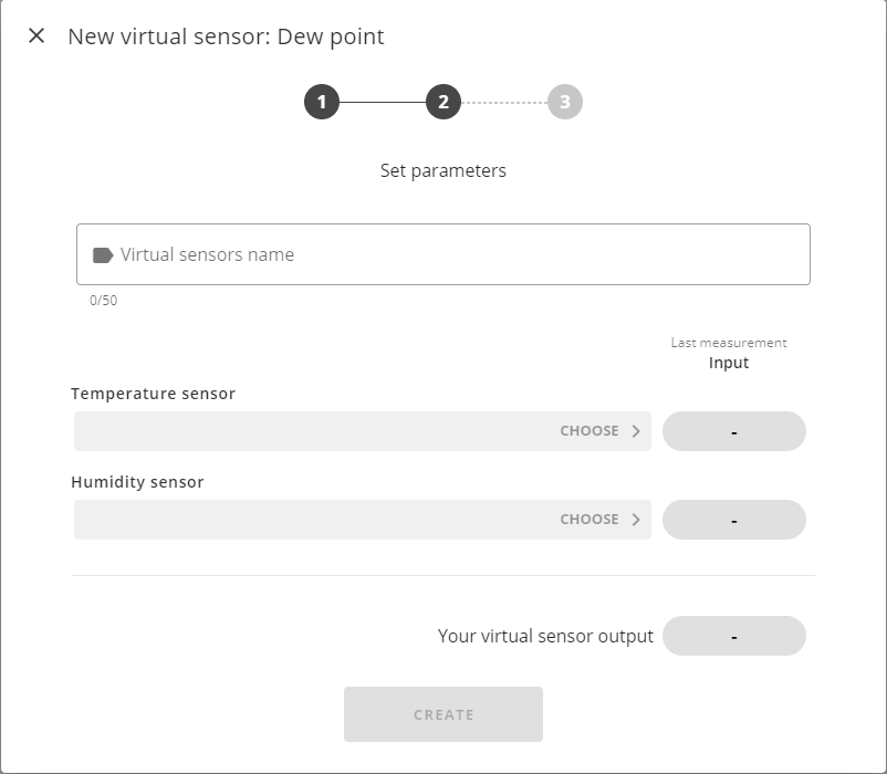

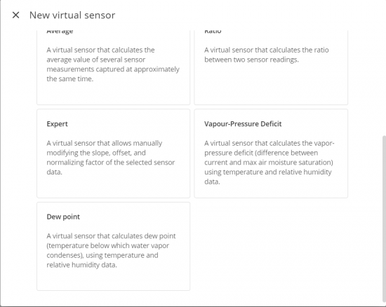

In Aranet Cloud, you can set up a Dew point sensor, which you can find under virtual sensors.\
When selecting it, you will be presented with this screen, where you can select the necessary sensors.:
<div data-with-frame="true"><figure><img src="https://forum.aranet.com/site/assets/files/4821/vsensor1.550x0-is.png" alt=""><figcaption></figcaption></figure></div>

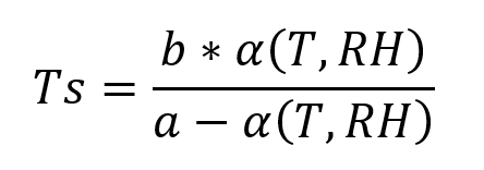

What kind of formula does this virtual sensor use:
<div data-with-frame="true"><img src="https://forum.aranet.com/site/assets/files/4821/image-2023-5-16_11-28-40.png" alt="" width="444"></div>
Ts Dew point (Celsius degrees)
T Temperature (Celsius)
RH - Relative humidity of the air (in percent)
a = 17.625
b=243.04
<div data-with-frame="true"><img src="https://forum.aranet.com/site/assets/files/4821/image-2023-5-16_11-29-25.307x0-is.png" alt="" width="307"></div>
