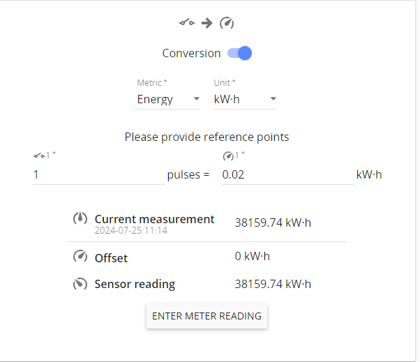

Starting from base FW version 4.4.4 and Aranet cloud version 2.0.68 you can add an offset to the cumulative pulse count.\
In the base station, you will find a new button when looking at the pulse counter settings: "ENTER METER READING".
<div data-with-frame="true"><img src="https://forum.aranet.com/site/assets/files/5295/ekranuznemums_2024-07-25_111551.png" alt="" width="602"></div>
Clicking on it will bring you to a screen where you can enter the number on your electricity meter.
