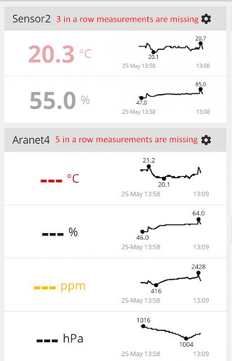

Sensor measurement readings in Aranet Cloud dashboard tiles are dimmed when the Cloud did not receive 3 measurements in a row. After 5 missed in a row measurements readings are replaced with dashes:
<div data-with-frame="true"><img src="https://forum.aranet.com/site/assets/files/2543/ac_missed_measurements.469x0-is.jpg" alt=""></div>
There may be some reasons, why sensor measurements are missing in Cloud, for example, the sensor has an empty battery or Aranet Pro base has lost internet connection. As soon as new measurements will be received, measurement will be displayed again.
