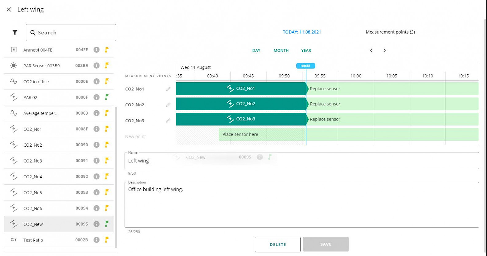

4. Click and start to drag the new sensor to the timeline. Assisting placeholders will appear on the timeline:
<div data-with-frame="true"><figure><img src="https://forum.aranet.com/site/assets/files/3013/ac_sens_replace1.1586x0-is.jpg" alt=""><figcaption></figcaption></figure></div>

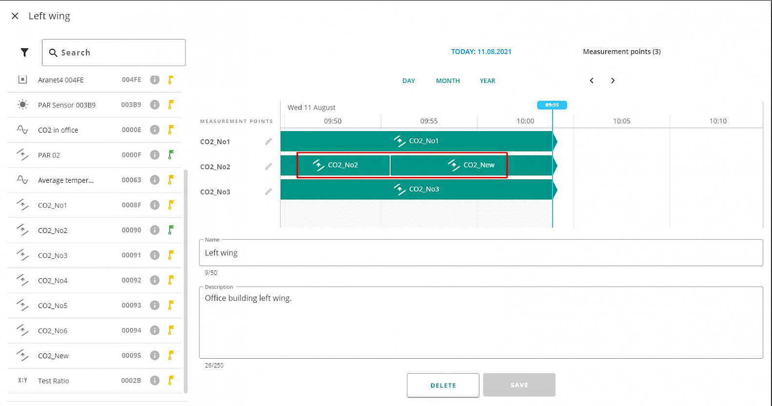

5. Drag and release a new sensor on the Measurement point of the sensor you want to replace:
<div data-with-frame="true"><figure><img src="https://forum.aranet.com/site/assets/files/3013/ac_sens_replace2.1583x0-is.jpg" alt=""><figcaption></figcaption></figure></div>
New sensor has replaced the old one in the measurement point starting from the current time. You can adjust replacement time by selecting the sensors ribbon and clicking on the edit icon. ![](https://2831658296-files.gitbook.io/~/files/v0/b/gitbook-x-prod.appspot.com/o/spaces%2FRKwQxnS51pLI9fOl4xXp%2Fuploads%2Fi324miSQoJyNLY6qAzHF%2Fimage.png?alt=media\&token=cf41f93f-425f-40d5-9b9a-f91fc50fe518)

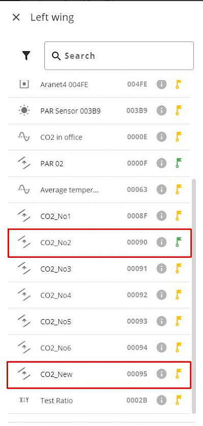

Now the sensor named "CO2\_New" changed its status to attached with a yellow flag, and removed from the Asset sensor named "CO2\_No2", which became available for attaching to another asset and has a green flag.&#x20;
