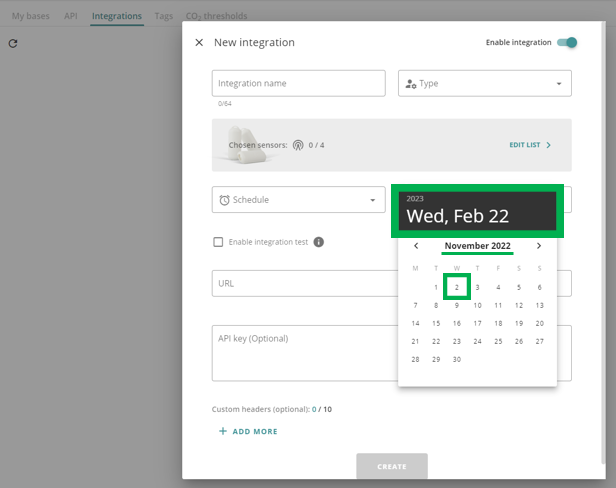

Yes, you can receive past data from Aranet cloud by setting the **Data start date** in the **Integration** configuration to the past date:
<div data-with-frame="true"><figure><img src="https://forum.aranet.com/site/assets/files/3786/image.png" alt=""><figcaption></figcaption></figure></div>
You will receive all available in the cloud measurement data starting with the date set. The Data is split into files containing 24 hours measurements.
