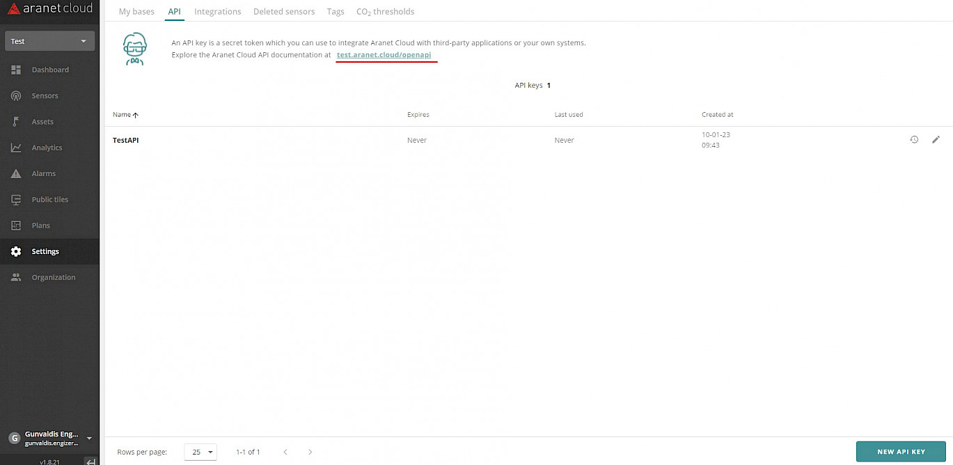

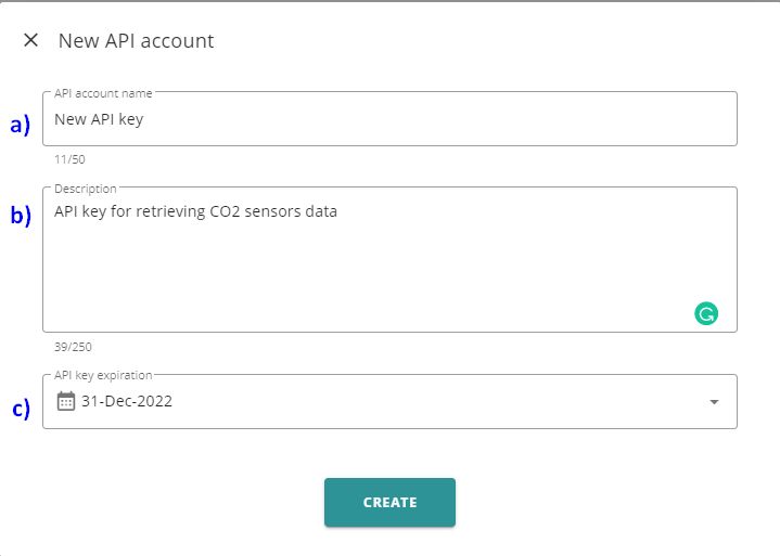

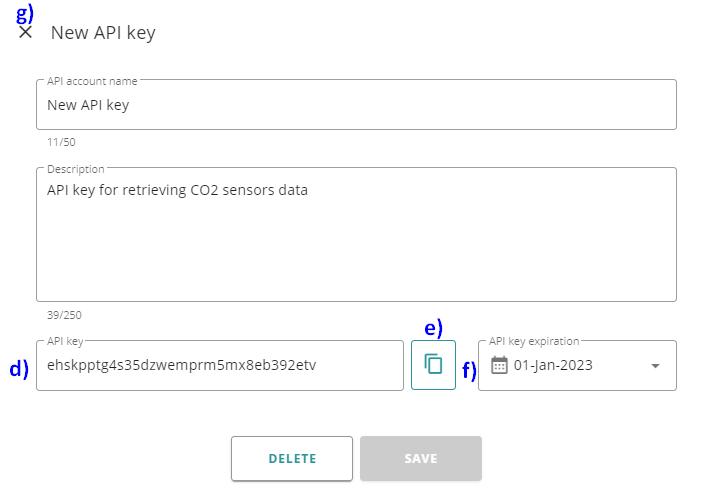

**API key**:
* Each 3rd-party system receives its own API key, which is used to authenticate data requests.
* One API key authenticates to only one Aranet Cloud workspace.
* By default, the API key has the same units configuration as the user who creates it.&#x20;
* A key value must be 32 characters long.
